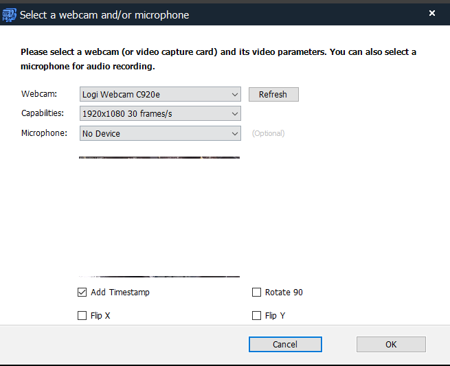

If you use CameraFTP VSS software, please make sure your source camera can support the resolution you ordered. In the case of webcam, please make sure that the webcam can support 1080P video. Many low-end webcams cannot support 1080P video resolution; or they may support it at a lower frame rate. In your VSS software, please edit the camera settings and check if the source webcam supports 1080P images.  See the screenshot below: ( Move your mouse on top of the camera live view, click the edit (pencil) icon, then click “Select another webcam/microphone”, then in the Capabilities dropdown, select the one with 1080P resolution.

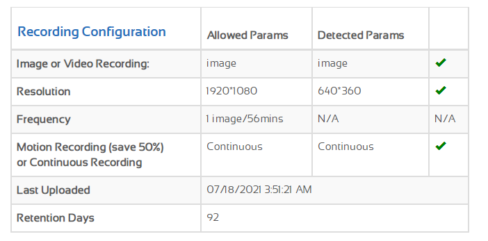

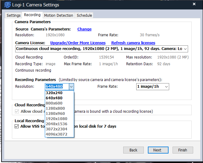

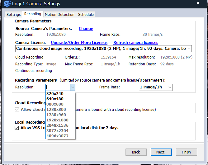

 The camera supports 1080.. But in the Recording settings i cannot set 1080, and it goes 640x360, all images that the subscription took every hour is in that low quality resolution
Please help!

 Still the same problem...
